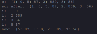

  • 对字典采用两种方式进行排序,但是最后结果不对?
    • 采用两种字典排序方式,但是结果都不对,求大佬指导-----
      # Untitled - By: PC - 周五 9月 11 2020
      import sensor, image, time
          # one method   排序
          c = {3: 56, 5: 87, 2: 889, 1: 0}
          sorted(c.items(),key = lambda x:x[0], reverse = False)
          print("c: ", c)
          print("sor after: ", c)
          # two method   排序
          newDict = {}
          for i in sorted(c):
              newDict[i] = c[i]
              print("i: ", i, newDict[i])
          print("new: ", newDict)
      ![0_1599786333727_1111111.png](https://fcdn.singtown.com/d6d90144-c6d2-4fd5-b9e6-a1cc1c17b25b.png)
    • 按照key排序:
      for i in sorted (c) :
          print(i,c[i])
      结果
      >>> 1 0
      2 889
      3 56
      5 87
      按照value排序
      print(sorted(c.items(),key = lambda x:x[1]))
      结果
      [(1, 0), (3, 56), (5, 87), (2, 889)]
