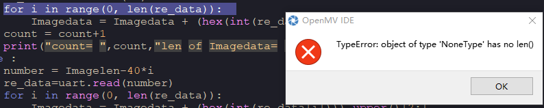

  • 为什么openmv串口接收大量数据时会报错?
    • uart = UART(1, 38400, timeout_char=1000)
      uart.init(38400, bits=8, parity=None, stop=1, timeout_char=1000)
      clock = time.clock()
      def getImagefrom32(Imagelen,times):
          count = 0
          print("This is getImagefrom32")
          Imagedata=''
          sendimage=[0x73,0x65,0x6E,0x64,0x69,0x6D,0x61,0x67,0x65,0x0d,0x0a]
          uart.write(bytearray(sendimage))
          time.sleep_ms(20)
          while(True):
              if uart.any():
                  for i in range(times):
                      if (i+1) !=times:
                          re_data=uart.read(40)
                          for i in range(0, len(re_data)):
                              Imagedata = Imagedata + (hex(int(re_data[i]))).upper()[2:]
                          count = count+1
                          print("count= ",count,"len of Imagedata= ",len(Imagedata)/2)
                      else :
                          number = Imagelen-40*i
                          re_data=uart.read(number)
                          count = count+1
                          print("count= ",count)
                  break
          print("len of Imagedata: ",len(Imagedata))
      ![0_1679385633651_联想截图_20230321160026.png](https://fcdn.singtown.com/dddaefcf-90d9-4f94-b529-3e539446c636.png)
      代码比较多,这里放最关键的一个函数。这个函数是让32发送一个JPEG图片的数据包到OPENMV,这个函数得到的参数Imagelen是JPEG图片数据流的字节数,times是我根据每次读40个字节,计算出来总共要读的次数。当32发送320*240图片,字节数大概在5000左右,如果波特率是9600或者19200,OPENMV可以收到,如果波特率增大,或者发送的图片变成640*480,图中while函数里面的for i in range(0, len(re_data)):  就会报错,说我的re_data没有长度,请问这是什么原因?
