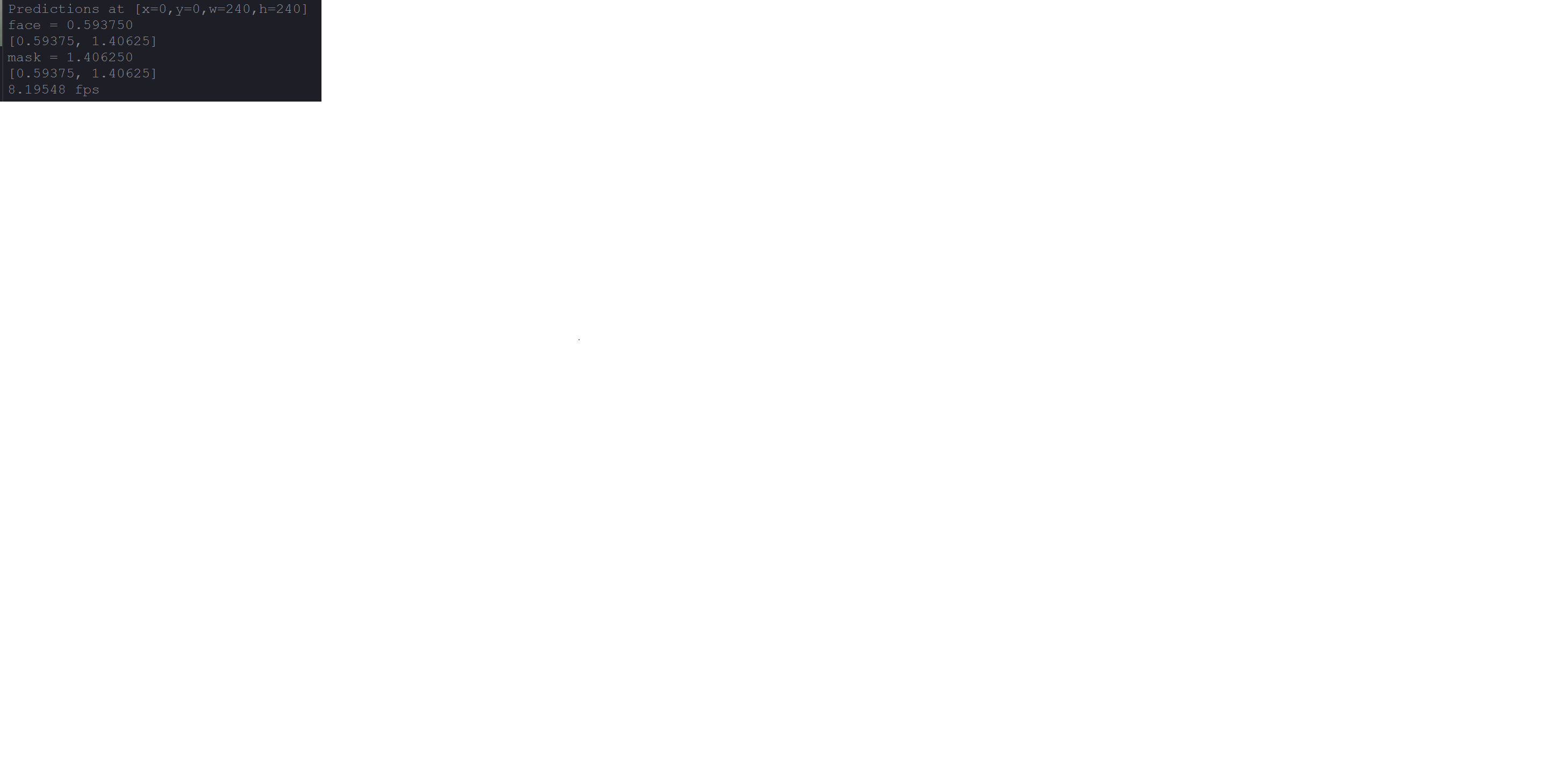

  • 口罩检测,将官方例程下进去发现返回值接近于1,并且两项和等于2,不等于1,请问解决办法是什么?
    • # Edge Impulse - OpenMV Image Classification Example
      import sensor, image, time, os, tf
      net = "trained.tflite"
      labels = [line.rstrip('\n') for line in open("labels.txt")]
          # default settings just do one detection... change them to search the image...
          for obj in tf.classify(net, img, min_scale=1.0, scale_mul=0.8, x_overlap=0.5, y_overlap=0.5):
              print("**********\nPredictions at [x=%d,y=%d,w=%d,h=%d]" % obj.rect())
              img.draw_rectangle(obj.rect())
              # This combines the labels and confidence values into a list of tuples
              predictions_list = list(zip(labels, obj.output()))
              for i in range(len(predictions_list)):
                  print("%s = %f" % (predictions_list[i][0], predictions_list[i][1]))
          print(clock.fps(), "fps")
      ![0_1641990699236_1.png](https://fcdn.singtown.com/ab07c07d-47d3-424e-ab28-75cafbfb6fc0.png)
    • https://github.com/openmv/openmv/issues/1502
      这应该是4.2.0造成的问题。
      你可以先烧录4.1.4的固件。
      这个问题会在以后的固件更新中解决。
