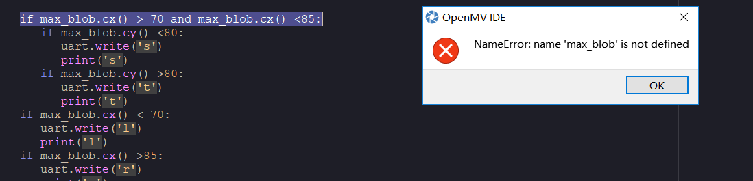

    • RE: 找不到目标就报错,找的到目标就可以正常运行???
      发布在 OpenMV Cam

    • 找不到目标就报错,找的到目标就可以正常运行???
      import sensor, image, time
      from pyb import UART
      import json
      # For color tracking to work really well you should ideally be in a very, very,
      # very, controlled enviroment where the lighting is constant...
      yellow_threshold   = (79, 43, -38, 73, 29, 102)
      # You may need to tweak the above settings for tracking green things...
      # Select an area in the Framebuffer to copy the color settings.
      sensor.reset() # Initialize the camera sensor.
      sensor.set_pixformat(sensor.RGB565) # use RGB565.
      sensor.set_framesize(sensor.QQVGA) # use QQVGA for speed.
      sensor.skip_frames(10) # Let new settings take affect.
      sensor.set_auto_whitebal(False) # turn this off.
      clock = time.clock() # Tracks FPS.
      uart = UART(3, 115200)
      def find_max(blobs):
          max_size=0
          for blob in blobs:
              if blob.pixels() > max_size:
                  max_blob=blob
                  max_size = blob.pixels()
          return max_blob
      while(True):
          img = sensor.snapshot() # Take a picture and return the image.
          blobs = img.find_blobs([yellow_threshold])
          if blobs:
              max_blob=find_max(blobs)
              #print('sum :', len(blobs))
              img.draw_rectangle(max_blob.rect())
              img.draw_cross(max_blob.cx(), max_blob.cy())
              output_str="[%d,%d]" % (max_blob.cx(),max_blob.cy()) #方式1
              #output_str=json.dumps([max_blob.cx(),max_blob.cy()]) #方式2
              #print('you send:',output_str)
              #uart.write(output_str+'\r\n')
          else:
              print('not found!')
          if max_blob.cx() > 70 and max_blob.cx() <85:
             if max_blob.cy() <80:
                uart.write('s')
                print('s')
             if max_blob.cy() >80:
                uart.write('t')
                print('t')
          if max_blob.cx() < 70:
             uart.write('l')
             print('l')
          if max_blob.cx() >85:
             uart.write('r')
             print('r')
      ![0_1558342482724_报错.png](https://fcdn.singtown.com/b9b0a8cc-b0bc-4313-b519-2e138364081c.png)
