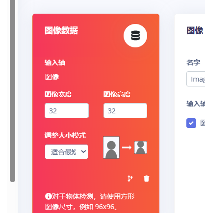

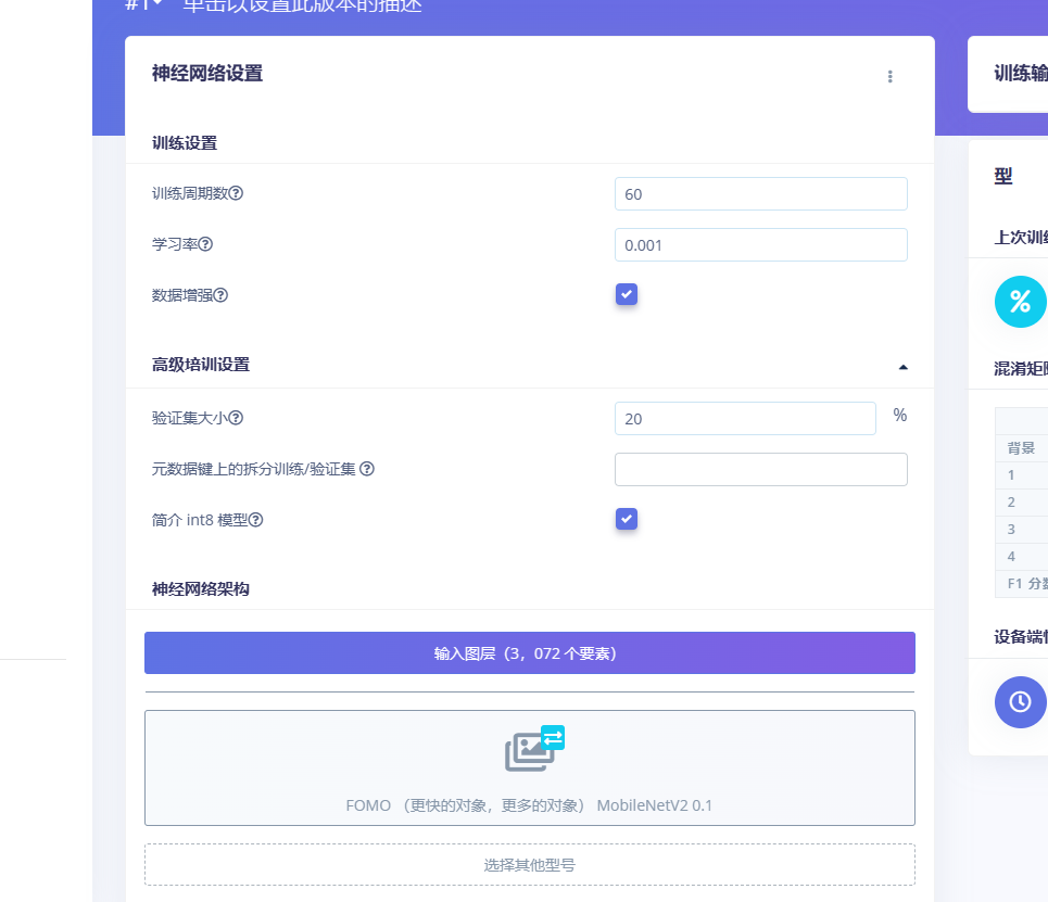

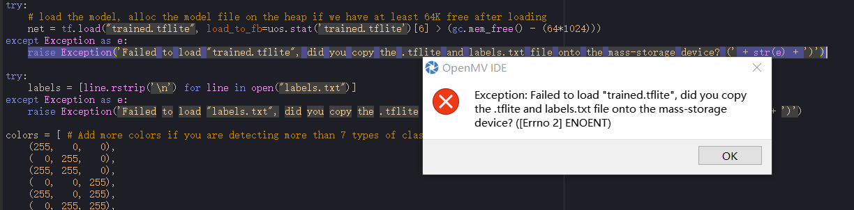

  • 图像大小由96×96改成32×32,用的openmv4h7plus,程序为什么还这么报错?

      ![0_1690455503173_A.png](https://fcdn.singtown.com/59e4b499-3814-4bea-924d-9ce17b290f0b.png)
      ![0_1690455511474_B.png](https://fcdn.singtown.com/38504516-c079-46c4-a8f9-c585e702a51a.png) ![0_1690455515039_C.png](https://fcdn.singtown.com/bf75c83b-0453-459d-b28f-f1b8767d3577.png)
    • 把生成的模型文件存到SD卡,插到openmv上
